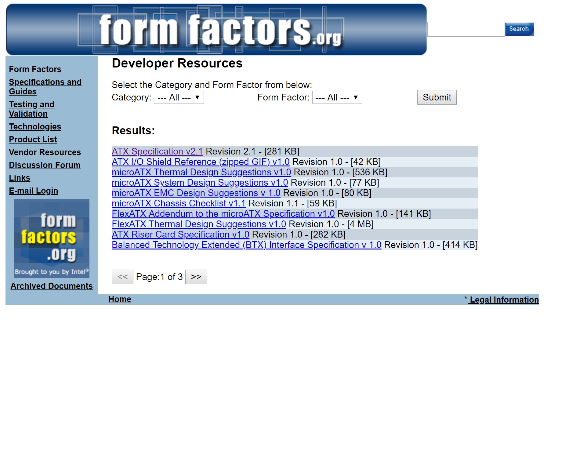

You can find PDF versions of the official Spec sheets over at FormFactors.org
